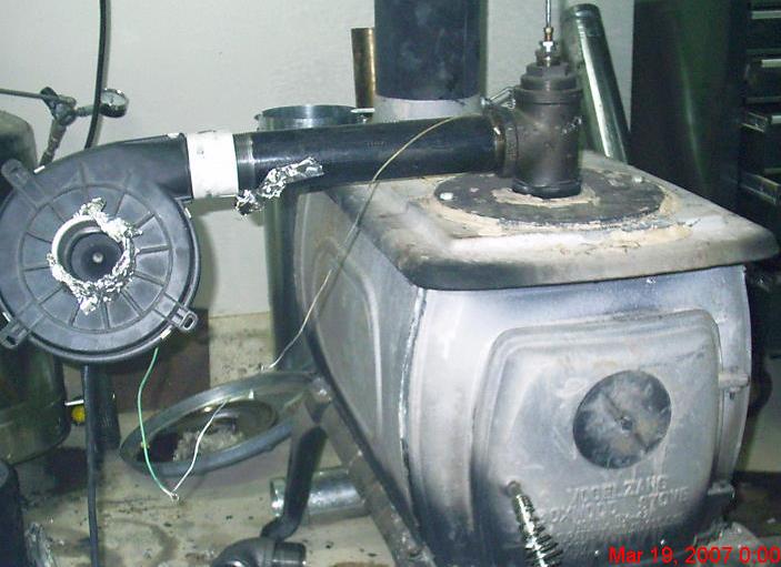

What do you call this kind of drip heater that they pump in air? Is it injected, pumped, ram, inducted?
http://www.otherpower.com/images/scimages/23/oil_stove.jpg
I'd like to research it but, I don't know what to call it.

Thats an interesting picture. Not sure what to call that one. Someone out in internet land aught to know?

It's a drip burner that has air pumped into with a blower instead of using a compressed air source. I guess it's called a forced air heater. The sanders heater has an update that's of this style. Looks like it can burn very clean. I'd like to build an other heater and was interested in this design.
Here's one in action.
http://www.youtube.com/watch?v=o-CFY9EmHzI
Here's a MEN heater.
http://www.youtube.com/watch?v=eWJcRmketlE
And this guy really gets some heat out of his burner but, takes it up one step, he pressurize his oil delivery system.
http://www.youtube.com/watch?v=yPe_itTsQ64
